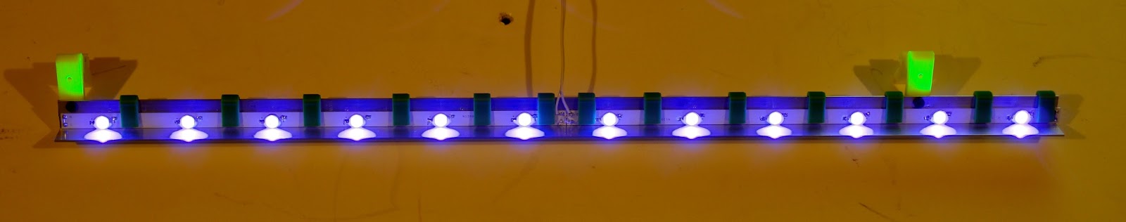

I love the uv lighting you use. Are those led strips or something else.
I drive my bed using two screws belted together with a single motor. It's low tech but I like the simplicity.

I bought a bunch of 1W UV LEDs and strip-type PCBs, soldered them together, then clipped them to aluminum L stock that serves as heatsink and light baffle.
I made two of those assemblies and installed them on either side of the front door alongside the white LED strips. The printed green brackets snap into the t-slot. I also put a smaller assembly on the top of the printer pointing down on the bed.
