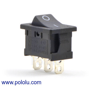

I was wondering about connecting an on/off switch as well.
How would I connect the wires from that to the inlet/power supply? I was searching for a long time and didn't find an answer. Do I connect the live to live and neutral to neutral like a DC switch or would I connect the live wire on both sides of the switch? An the middle is ground right? So I should connect that if I don't want to trust my life to a random chinese company?
This one looks close to the one I have:
Sorry I am a total noob to electronics.

Switch the live side. One line goes to the center terminal, the other goes to the normally open terminal. Grab a meter to confirm which one this is, its the one which is connected to center with the switch in the on position. Neither neutral nor earth go to the switch, connect them straight to the supply. Use insulated terminals to make the connections and mount it on a printed enclosure similar to the one nophead linked.
Re: Prusa Mendel 2.0 Question
July 31, 2012 09:13AM
Awesome, thanks Andrew! smiling smiley
