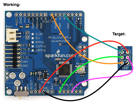

Dust
You have badly setup 1284p fuses.
The fuses on the 1284p set some of the functions of the pins, including jtag. If jtag is not turned off, those pins misbehave
This kills pins 24-27, ie x-stop,y-stop,z-stop and X direction.
see [github.com]

Dust
your going to have to use command line tool avrdude to change the fuses... same ssue I had you cant cant change the -B flag from withing the GUI..
