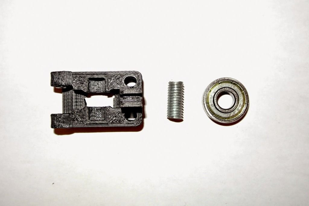

Hello, I purchased a wade extruder from Maker Geeks, and I got the set with the screws/nuts etc, but I can't find the center bolt in this pic:
Here is the kit: [www.makergeeks.com]
It shows everything I have, but it doesn't show that one part, so what should I use?

I believe that would be a 8mm diameter by 20mm long piece of threaded shaft. It does not need to be threaded, if you have some left over 8mm smooth rod it would work just as well.
