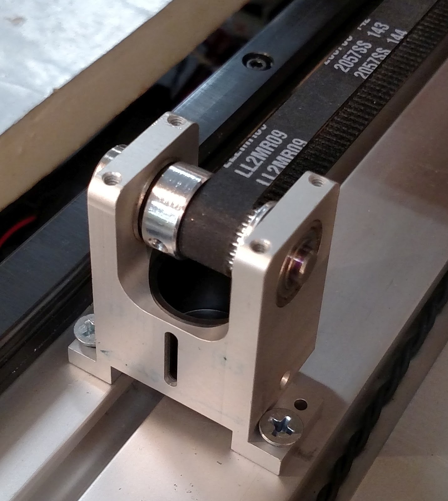

Nice little Bearing Block pity about them screws.Quote
the_digital_dentist
I had a piece-o-junk from something I took apart years ago with two 1/4" bearings press fit into it. I needed to make an idler pulley for the Y axis in one of my printers and discovered that an off-the-shelf 20 tooth GT2 pulley fit perfectly between the bearings. IRIC, I put two small washers on either side of the pulley to ensure that it could only contact the inner rings of the bearings. I had a 1/4" shaft from some other piece of junk I took apart.

Diggrr
I was pondering last night about spring pins, using a close fitting clevis or yolk with the same size holes to contain the bearing and pin. They're basically a spring steel tube with tapered ends made to drive into a dowel hole, but hold with outward spring tension instead of adhesives or an interference fit.
Untried, but a thought none the less.
It doesn't take a great deal of force to insert a spring pin, so unlikely to damage the bearing.
Probably not useful for a one sided mount.

etfrench
Actually, shoulder bolts were not designed for bearings although many people use them for this. Most shoulder bolt shoulders are .002" to .004" undersized which makes for a very loose fit in a bearing. McMaster-Carr has precision shoulder bolts which are -.001" to 0" and would be a better choice.

cozmicray
etfrench
What were shoulder bolts designed for?
