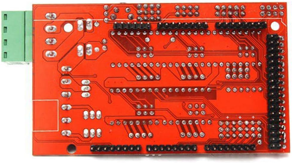

Thanks, understood. I managed to destroy my gen6.d board today by leaving the printer out on the balcony when it started to rain. I guess the rain shorted out the electronics. I'm assuming the stepper motors, hot end, and limit switches are all still undamaged by the rain, so I think all I need is a new electronics board to get back up and running.Quote
Dust
Ramps is just a shield, it needs to be on a mega2560, or even better a re-arm 32 bit controller.

Thanks; with this information I could find some ribbon cables on amazon with the proper connectors.Quote
Dust
stepper plugs are for 4-pin Female Dupont
endstops are 2-pin Female Dupont
What would be the likely consequence of supplying only 10 amps total?Quote
Dust
You need 11+5 = 16 amps power supply (minimum) , and yes they are just wired in parallel to the suplly.
If you don't have a heated bed, you don't need the 11amp wires at all. (11amp circuit is just for heated bed/D8 mosfet)

Well, miracle of miracles, I seem to have been able to revive the old gen6.d board by spraying it with warm tap water and drying it with a hair dryer. I'm assuming the years of dust buildup on the board (which is not enclosed in any protective housing), combined with the rainwater, led to some partial short-circuit, which now hopefully has been resolved.Quote
qrp-gaijin

In that case, my plan will be:Quote
Dust
"which has a small 12 cm x 12 cm heated bed"
its the 20x20cm bed that take about 11 amp.
if it was working before on 10 amp total, you bed probably takes less that 5amp..

My MKS GEN L v1.0 board finally arrived, and I was immediately able to upload my self-compiled Marlin 2.0 onto the board, with no hassles. I was happy to see that I could upload firmware and test the endstops without needing to connect the 12V power supply -- the power supplied over the USB cable was sufficient to power the microcontroller.
Next, I want to test the motors, which will require the 12V, 5A power supply to be connected. It would be more convenient if I could use a pluggable connector instead of the screw connectors. Can anyone suggest a small form factor connector that can safely handle the required current (16A maximum, including the heated bed)?
The reason i want a small pluggable connector is that my printer is a small portable type that I move around often (I put it outside, with good ventilation, while printing, and take it back inside when done). When moving the printer, I want to disconnect the bulky power supply easily. But the current screw connectors for the power supply can't be disconnected quickly.
