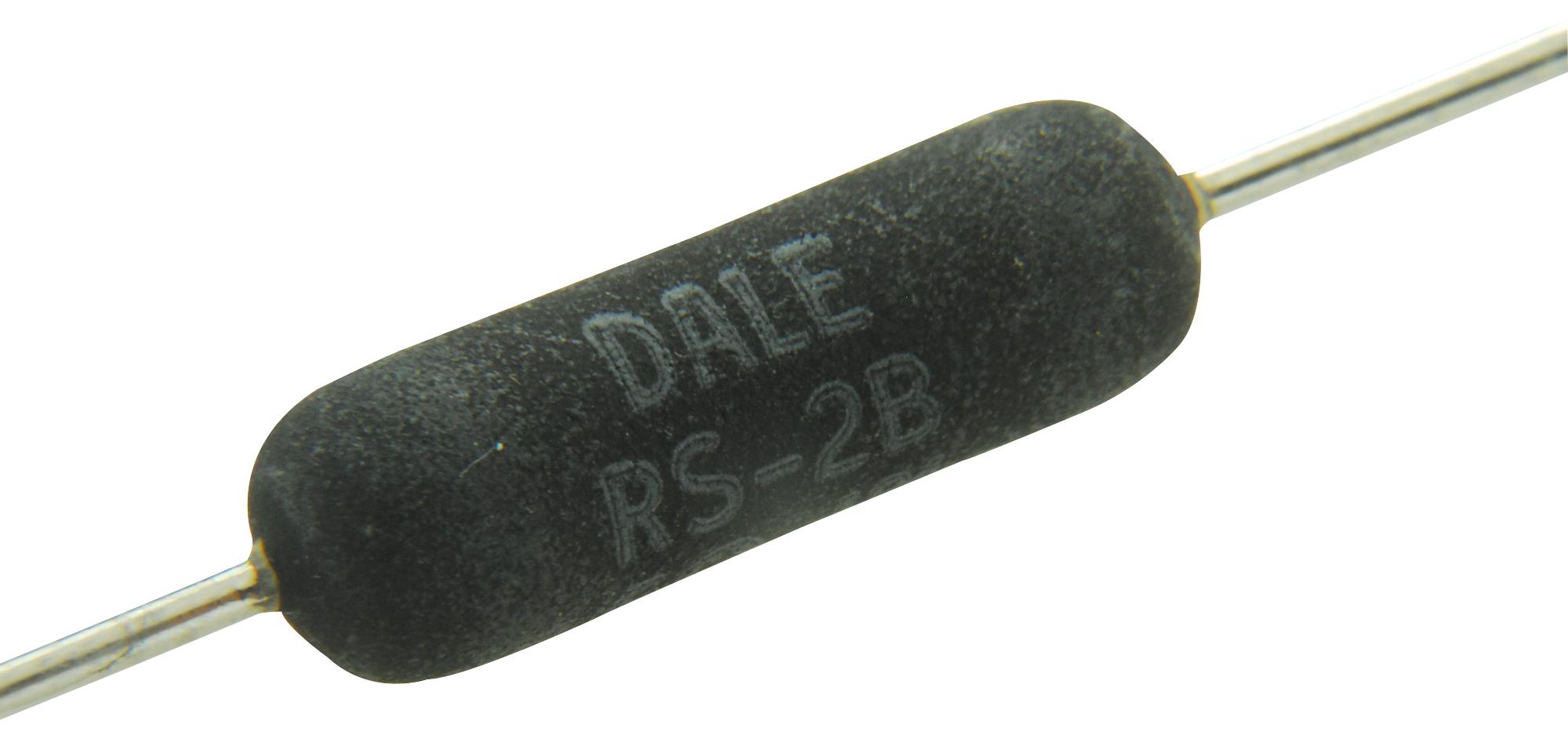

Is this resistor suitable as a heater for the hot-end? March 30, 2021 10:43AM |

the_digital_dentist
The heater block is aluminum. You could drill it out to 6mm in about 3 seconds with a hand drill.

Well, yes actually. Ignoring the 30W resistor which is a red herring, a 3W resistor will use about the same length and diameter of nichrome wire as a 30W cartridge heater.Quote
................. Let's consider the construction of wire-wound resistors for a moment. Do you think a 3W resistor uses the same diameter nichrome wire that a 30W resistor (or a 30W heater cartridge) .....................

leadinglights
I will be interested in how well your silicone resistor holds up although I am a little skeptical as the vitreous enamel ones can be driven to a red heat for some time before failing but I don't think that the outer insulation on a silicone one would take it as well.
