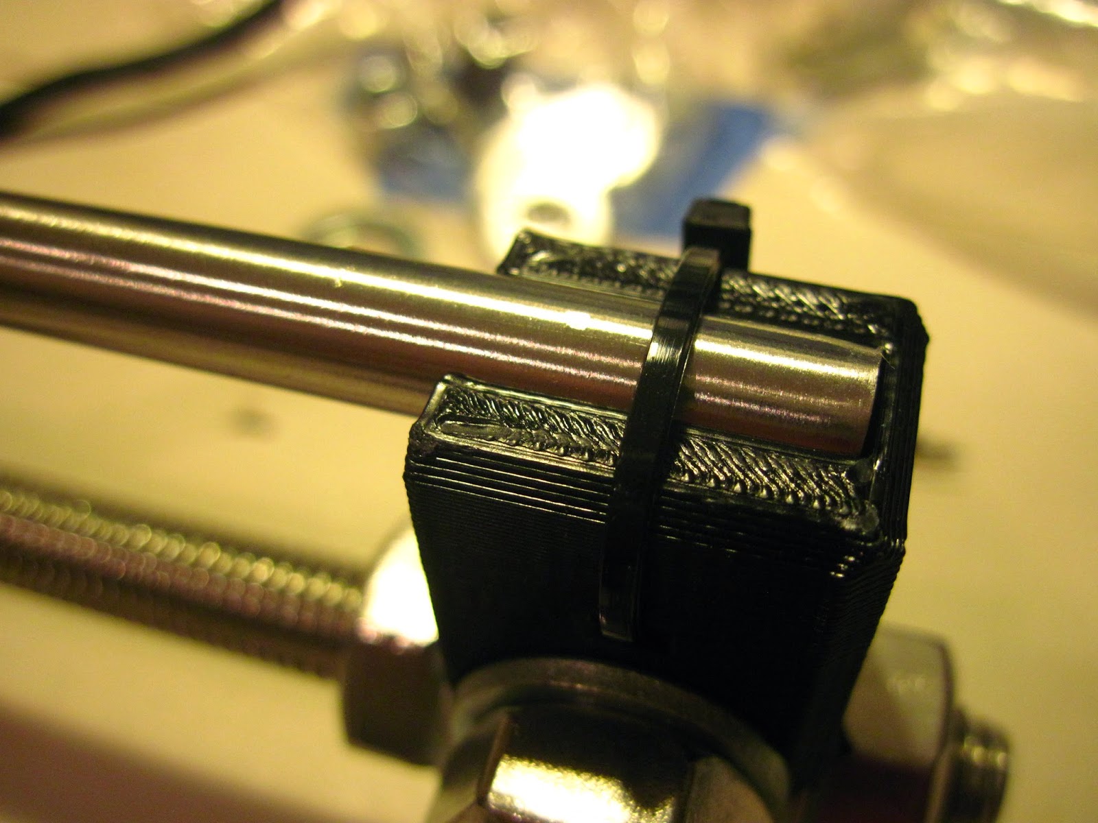

Hi All,
Have been reading this thread for a while now, and have now ordered and build one of these.
Mechanically everything seems to be OK, except the extruder.
I raised the z-axis and am trying to manually extrude ABS, but it always gets jammed. If I set it to extrude by say 50mm, as long as I apply downward pressure on the filament by hand whilst the bolt is turning, it will extrude, but as soon as I release the pressure, it starts slowing down until a complete stop.
Without the downward pressure, the bolt eventually chews up the filament. I have tried increasing the temp to 240degC, tried loosening/tightening the hobbed bolt bearing. When it gets jammed and I pull it out, it appears to bulge. I've attached photos of the bolt chew, ABS bulge and fan position. Anybody have any ideas? Maybe the hotend is partially blocked?? The filament tends to curl up as it comes out of the nozzle. Maybe even the quality of the ABS Replikeo send perhaps?
Any help from experienced extruderists would be greatly appreciated.

I had the exact same problem when I started out with my RepRap. I had the same bulging piece on the filament and tried everything, like you did. The only thing that worked at the time for me was pinching the extruder shut more tightly (by hand).
In the end, I decided that the design of the printer was not working for me. Long story short, I ended up switching the long M3 screws with springs that squeeze the extruder shut for shorter M3 x 25mm screws with washers that press directly up against the plastic (no springs). This caused the extruder to pinch tightly enough against the filament, and I continue to use it today with ABS and PLA because it is repeatable and works each time.
I would definitely recommend doing that; it's worked a charm for me so far.

That's great news, I will definitely try that and see how I go. Also, I was constantly browsing your build thread and crosschecking as I was building the machine, was super helpful. So thank you very much for all the help you have provided.

Hi Blue Ice. I didn't have the correct length screw and just decided to trim the long screw down a bit so the springs would be a lot tighter. This worked well, extruding was much better and uniform. So I started to print a cube, about a third of the way though, the extruder motor started stuttering and would stop the stuttering if I applied a small rotational force to the gear to help. In the end, the filament got chewed again. So I took it out, cleaned all the debris, and increased the motor pot by about an 1/8. Now I tried again and it worked, didn't have any troubles extruding throughout the print. Again thankyou for the advice. Only thing I need to look into now is it printed x and y at more or less 20cm, but only printed 15cm high. Regardless, I am rapped that I have actually finally printed something.
Edit: 20mm I meant. I think all I need to do is modify the steps per mm in the firmware.
#define DEFAULT_AXIS_STEPS_PER_UNIT {80,80,4000,607}
All right! That's awesome that you got it to work!
It seems like your problem with height could be caused by an incorrect value for the DEFAULT_AXIS_STEPS_PER_UNIT value in Marlin. If you get stuck, here's mine:
