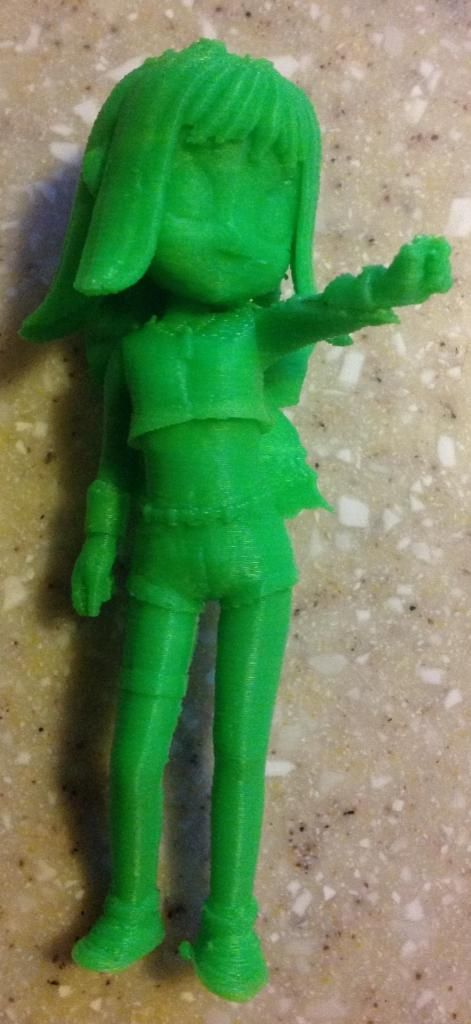

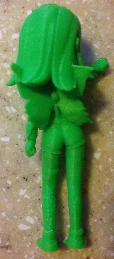

This is my best print to date. It was a pretty complicated single print, and I am happy with it for the most part. I did have a problem in two spots unfortunately. One is on the arm sticking out. One of the layers on the arm popped off during the print. Lucky, I was right and was able to salvage the print and just glue it back on once the print finished. One of the wing tips did the same thing, but I was unable to glue it back on due to it looking like a pile of spaghetti. Other than those two minor flaws, I am incredibly impressed with this print so far. My four year old bugs me relentlessly to print her new toys. I have hardly had a chance to print anything out for myself yet.

Re: Folger Prusa i3 Kit from ebay
March 02, 2015 10:51AM
Turned out really well smiling smiley
