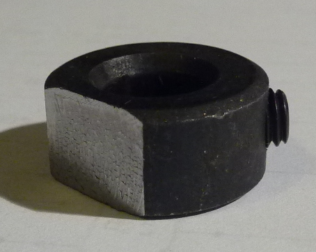

No, the printer does not come with an SD card. I still haven't tried printing from an SD card with mine. I have a dedicated computer connected to the printer, so I don't have much need at this point.Quote
bernbout
1. Did Geeetech supply an SD card or do I have to use my own?
I have it sitting behind mine printer on the table.Quote
bernbout
2. What did you do with the A.C power unit?
They supplied a plug+ socket/switch but no instructions of how it is to be connected. The reason I ask is, for the other, Acrylic Prusa's, they suggest mounting the PSU on the Side support. In this case, there is no such support. So did you just leave it lying on the table or what?
The boat is 3DBenchy from Thingiverse. The fan parts I designed myself. It was intended to cool the part being printed. It didn't work in the end due to not enough pressure blowing out.Quote
bernbout
3. Your prints look nice considering the printer is quite new. Did you design these yourself? Any link to the 2 parts you printed - the fan and the other part and what are they for and how fitted?
bernbout
4. I was thinking of mounting the PSU sideways on the RIGHT main frame by drilling 2 holes in the main frame
and also print a small box to hold the Power socket and switch and fix it to the PSU as shown. What do you think?
After successfully setting up & printing, I want to build an enclosure for the printer similar to this one.
