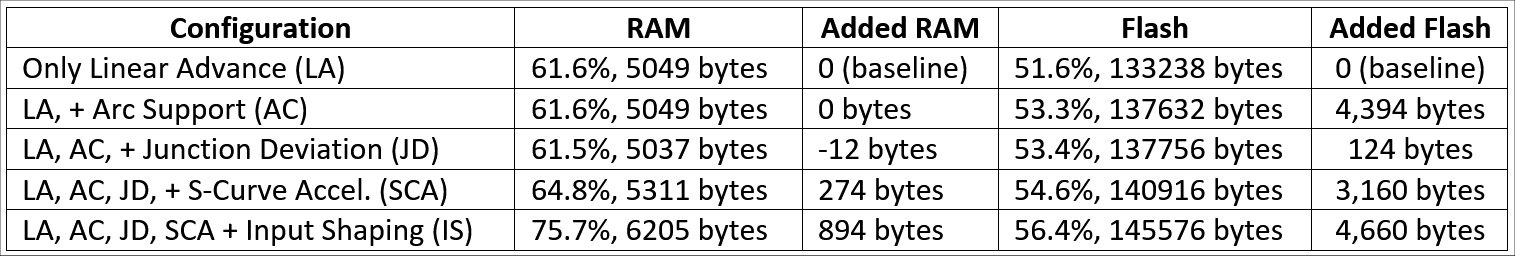

I have a 2017 MakerGear M2E printer, with a RAMbo 1.4 controller. It has been a very solid workhorse, running Marlin 1.0. I just updated the firmware to 2.1.2.5, primarily to take advantage of Linear/Pressure Advance. I've got that calibrated, but haven't done any prints yet to see how much it helps.
In the process, I discovered a whole raft of new enhancements that sound potentially useful: Input shaping, Arc Fitting, S-curve Acceleration, and Junction Deviation. My concern is that if I just turn every bell & whistle on at once, my RAMBo could have a nervous breakdown. I asked the Google AI, and it suggested Input Shaping (for example) could use enough processor cycles & memory that I could run into trouble. If the result is compile errors, that will be a big clue. I also don't want to load it with firmware that fits, but can't run reliably.
It sounds like Arc Fitting may actually reduce the workload on the processor/memory, so I'm probably going to enable that. Does anyone have any experience with how much I can ask of my controller board in terms of the remaining features? I'd like to balance reliability with the mix of features that provides the most improvement in print quality.

I did some experiments. I started with a baseline of Marlin 2.1.2.5, with only Linear Advance activated. I then added all the other features that are available, re-compiled, and kept track of the memory usage. Here are the results:
Although they definitely chew up some memory, I don't appear to be too close to running out of either RAM or flash, even with everything installed. I found another web site that did a similar analysis for features in Marlin 2.0:
Marlin 2.0 Memory Usage vs Features
One thing that can apparently chew up a lot of memory is any form of auto bed leveling. The MakerGear M2E has a steel frame, and is built like a battleship. I only have to check the bed level once or twice a year, so I don't need auto-leveling.
The one piece of my original query is how much improvement I will see in my prints with each of the various features. Given that I can apparently run them all with no penalty, I don't have to pick and choose, so it's not as much of a concern...
