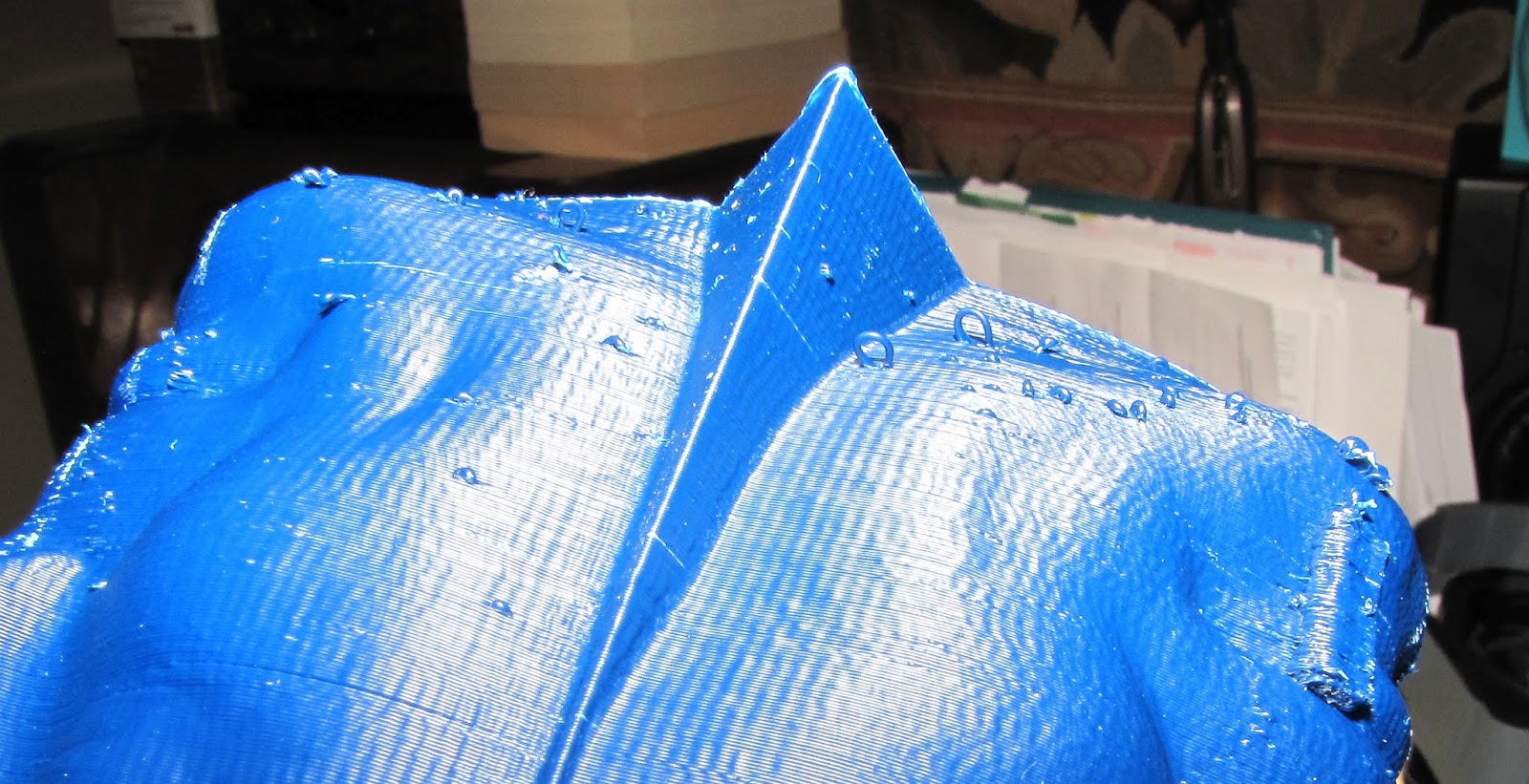

NathanaelXYZ
...appears to be filament dust on the roller threads in your posted image...
