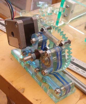

I also made a laser cut one for Huxley Seedling using Springs to pull the Clamp It worked on my first build ok but finding good springs caused me to abandon this design for ABS..
