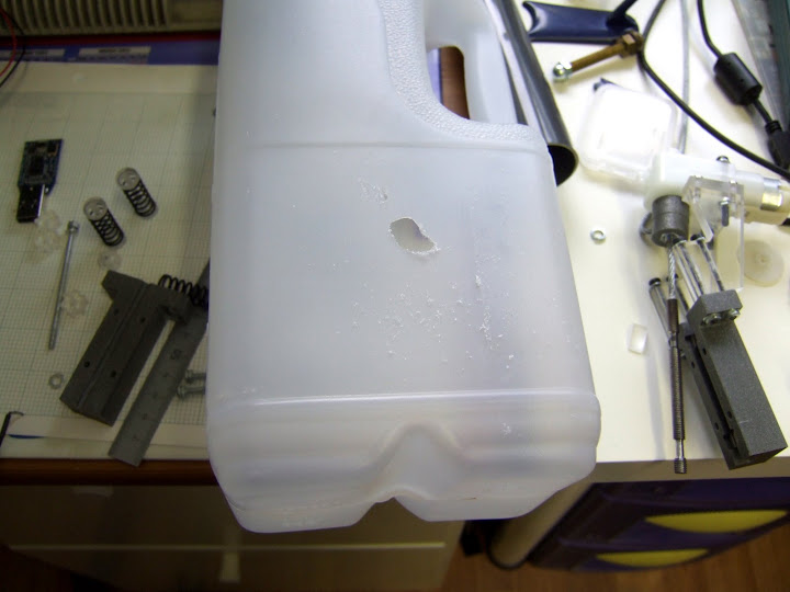

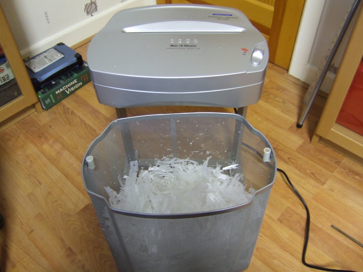

I have put HDPE milk bottles through a crosscut paper shredder and took photos intending to blog it but I never got round to it. I cut them with scissors first so that they were approximately flat.
After one pass they are in strips stuck together by thin webs: -
[lh6.ggpht.com]

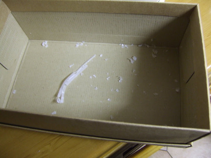

HDPE is one of those plastics that is very hard to tear, it just stretches very thin and gets very strong. There are some small chips as well though. Sieving it and putting it through repeatedly does yield lots of small chips.
[lh6.ggpht.com]
I don't know how long the shredder will last doing it.
Attacking it with a milling cutter produces a fine dust: -
[lh6.ggpht.com]
Using a hot funnel to melt it to a thin stream fed to a small milling cutter is appealing, but I think it is too viscous to flow under gravity unless you get it very hot and then you risk denaturing it.
