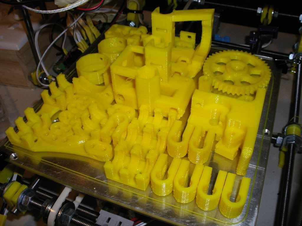

I have been printing with the first of the prusas that I assembled for sale for about 9 months with no problem. It has a number of features that aid reliability:
All metal hotend: no popping nozzles out of ptfe when the temp gets a bit high. this is a common failure mode for many.
lm8uu linear bearings: these keep on trucking. PLA bushings would have worn out or gone sloppy by now.
glass build platform: remains flat. very durable.
stainless frame and rods.
The full 200x200 print area is usable:
[i1236.photobucket.com]
[forums.reprap.org]
