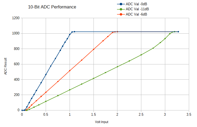

newbob
ESP32 ADC has non-linear response and lookup tables have yet to be provided by espresiff.
Re: ESP32 Printer Board July 27, 2017 12:37PM |
Registered: 10 years ago Posts: 126 |
CthulhuLabs
newbob
Well that could be a problem.
