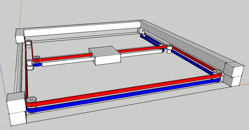

Has anyone used both ? 2 level belts would be a lot easier to implement . Another thing , looking at the picture I attached from fabtotum dot com , it looks like all 4 belts are attached to the hotend carriage and not one side passing through. Is that correct? This is on the 2 level design they have.

There are only 2 belts ( a blue one and a red one).
They are in different levels and both ends of each belt is attached to the carriage.
Like this:
