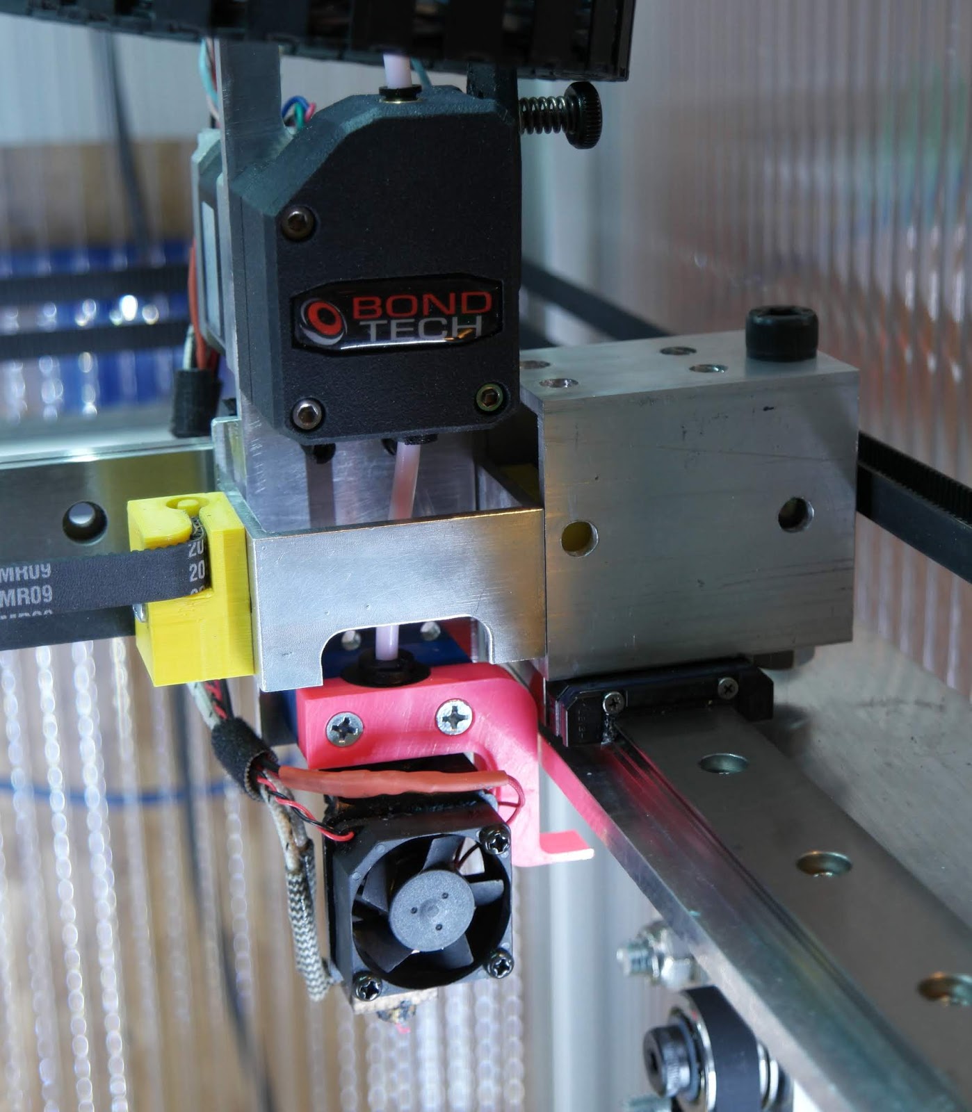

the_digital_dentist
Yes, two linear guides for the Z axis. No, no alignment or thermal problems. The linear guides are bolted to t-slot that is bolted to the printer's frame. There is a t-slot cross bar at the bottom and the bed support is also a t-slot that runs across the two Z guides. I was concerned that with the chamber being heated that there could be some problems if the whole frame didn't heat up as a unit, but it works fine.
