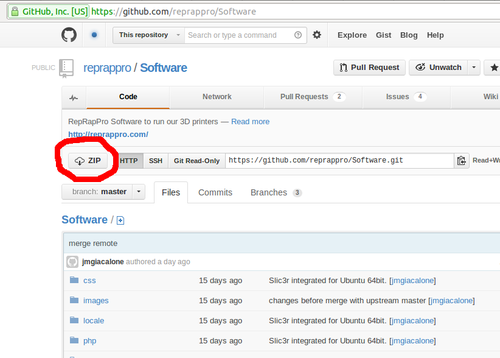

The first thing to establish is that you can communicate with your machine. You now need to install and run the RepRappro Pronterface software, which you will find in our github repo here. The button to download a ZIP file is near the upper left (the little picture of a cloud with a down-arrow labelled ZIP).
Extracting the ZIP file will create a folder called 'Software', which contains the communication software Pronterface.
