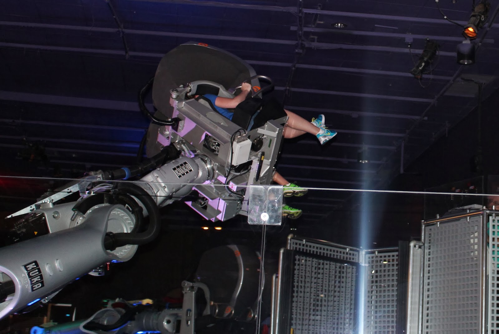

Remotely, and pragmatically dig holes in the yard, scale it up and dig a pond, or a basement, switch the backhoe out for the 3d cement extruder to finish the job! Mount a chair to it for a flight simulator
The worm gear will be inherently safe if you loose power too.

see3d
Too Funny!
I just finished rebuilding my DIY tractor backhoe attachment last week. I never though about putting a seat on the bucket and running the joysticks out to the seat and taking it for a joy ride.

There is software that in real time can give feed back of topology of a dynamic environment (the hungry human) to avoid collision. Or place reflective markers near the mouth to identify the target.|
