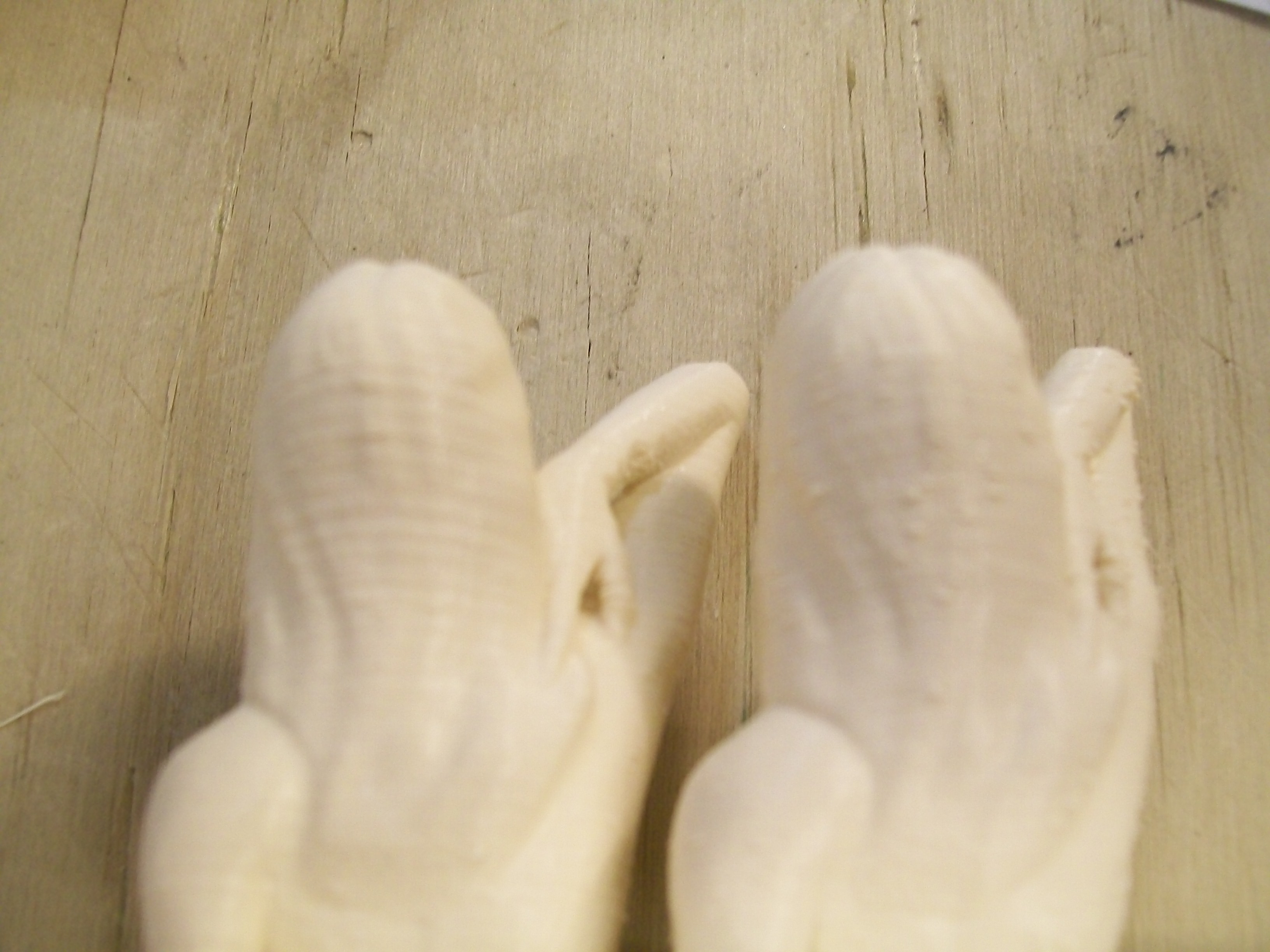

When I look at the pictures I notice a couple other things.
1) The good print still has the same pattern being repeated along Z just a lot smaller but at the same frequency which implies to me that it is still the z axis causing the issue.
2) The corner of the good print is much rounder which could be hiding ripples a little.
I am having a hard time seeing how the X/Y acceleration could change the Z artifacts.
A lot of people with Mendel variant machines swear you need to run a layer height that is a multiple of full steps. I never found it was needed for my machines but maybe that has to do with the imperial lead screw? Have you tried running Z with full steps enabled and a layer height that is cleanly divisible by the mm/step?

I to am too having trouble understanding why the X/Y acceleration helped with this.
A full step on my Z is 0.005mm so I will give running it in full step a go and see how it goes, it sounds to me like a more plausible solution to me. One other theory I have is that the step rate/frequency gets high then the audrino cannot handle it and funny things happen. So lowering the step/mm could be a good thing for loading on the audrino, though I really do not know enough about these things to make good theories up.

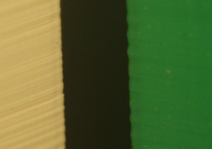

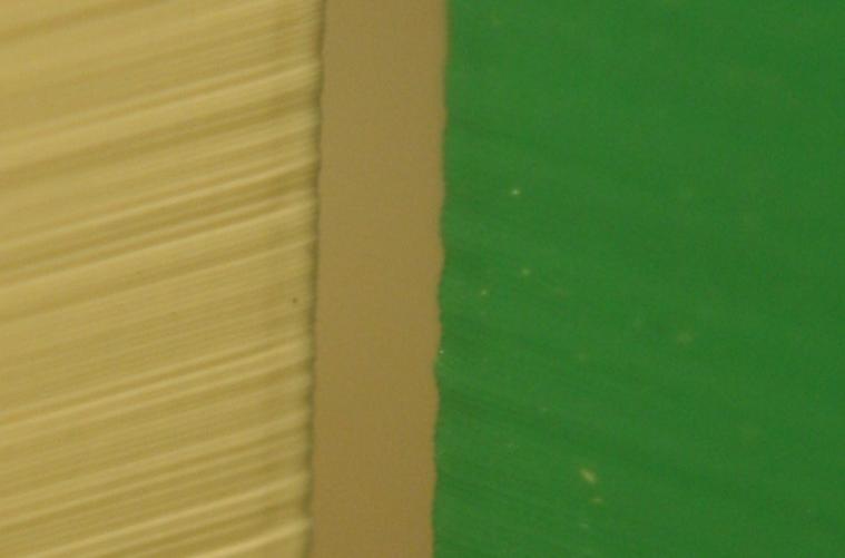

Here is something else interesting on the banding, if you look at one side then carefully draw a line across the print to the other side it shows the layer is just larger all around, like the Z has not moved correctly to the right distance:
Also you are right about the corners:
Looks like a larger corner radius hiding the issue.
I might also try and DTI the Z axis while it is running and see if it actually moving the correct distance.

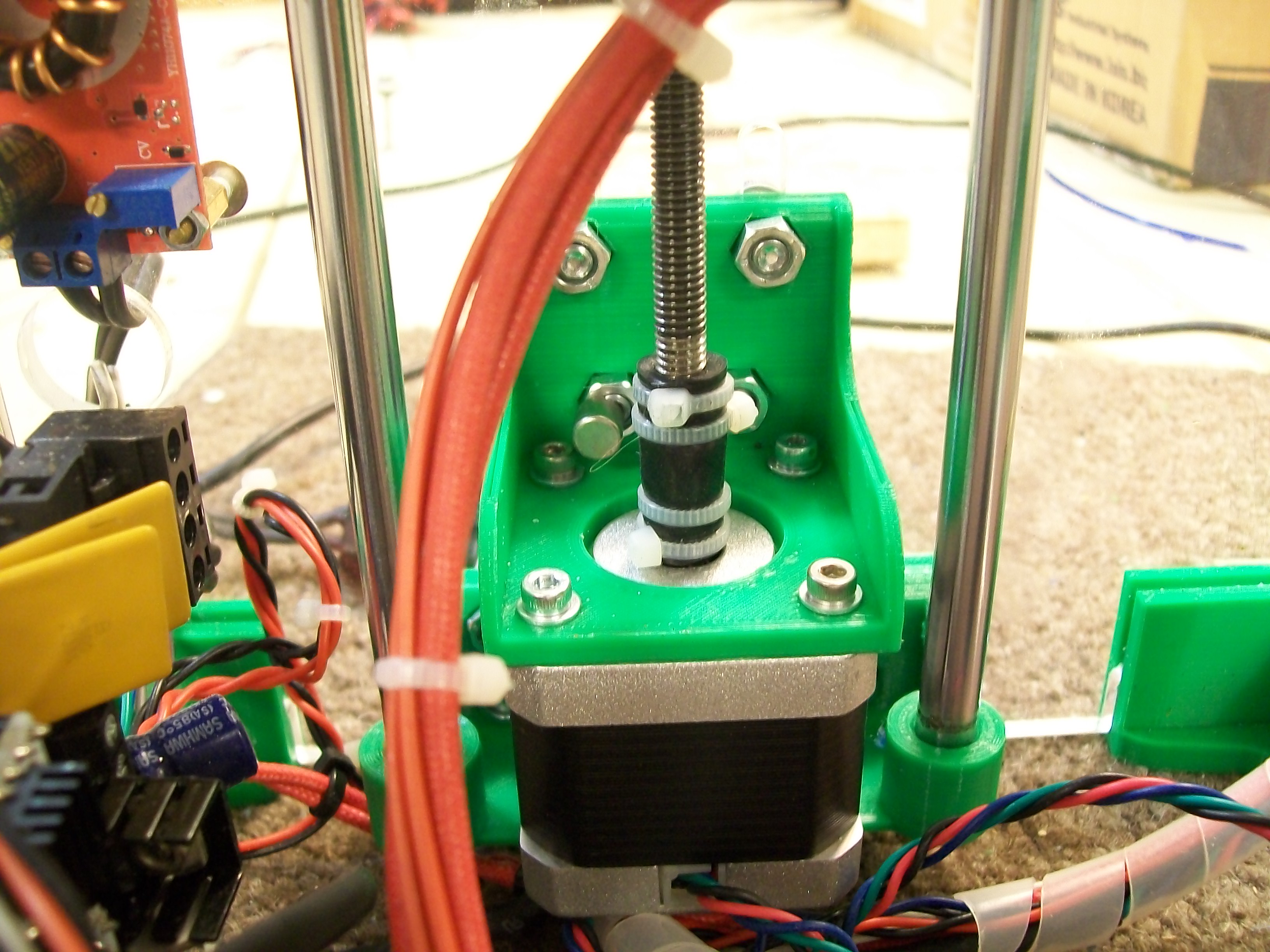

Mod1: Replace the coupler with 4mm ID silicone hose. This worked really well and is much more compliant than any proper couplers. I made sure there was an air gap of 2 to 3mm between the motor shaft and threaded rod. I also jammed a cable tie down the motor shaft flat. It does not slip at all.
http://www.edns.co.nz/tantillus/banding/coupling.jpg

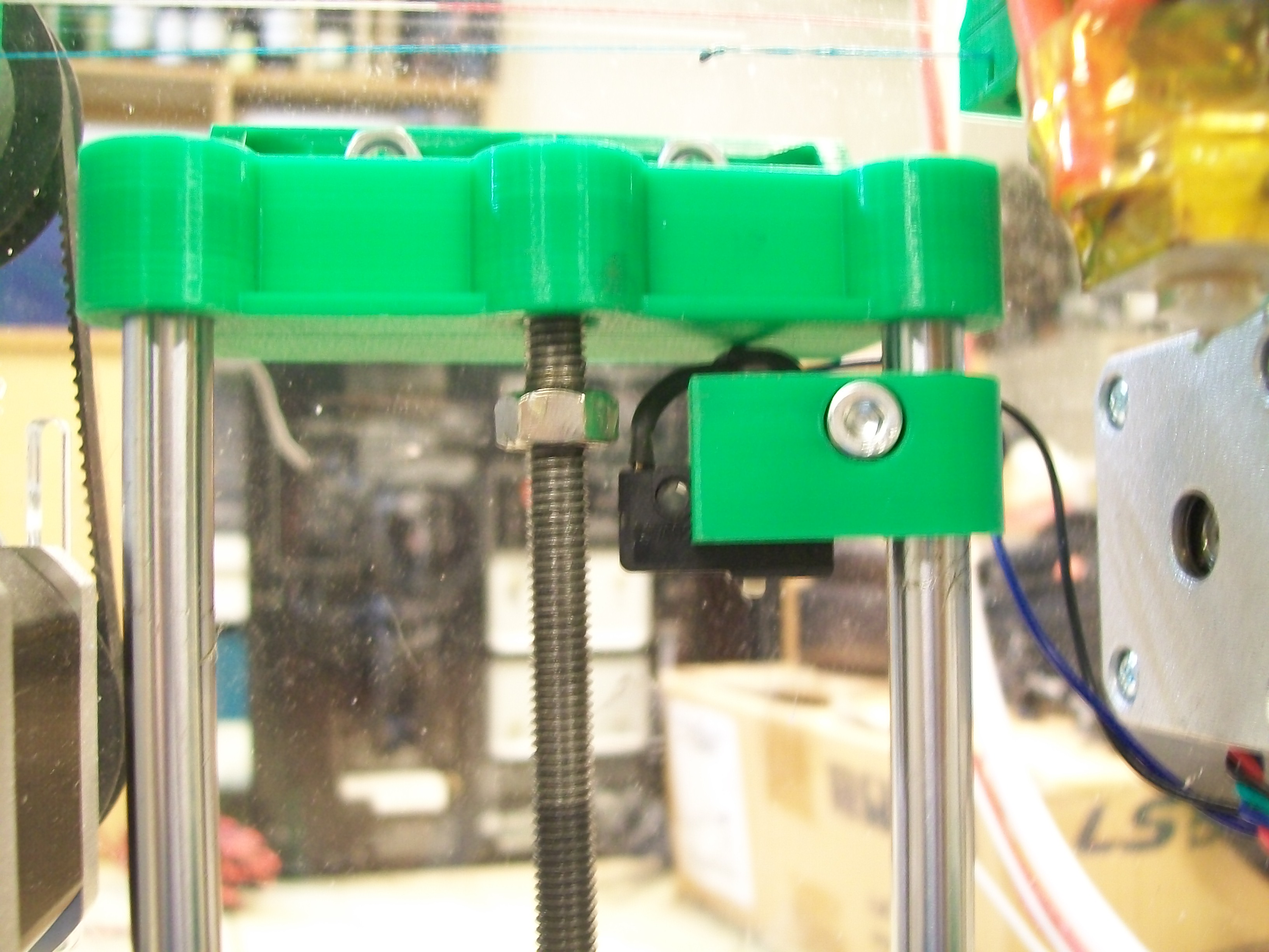

Mod2: This is dodgy. I took the top nut on the z lift and glued it so it would no longer be engaged and the spring is just floating on top now so the table is just resting on the nut by gravity instead of a spring. My bed is heated so it is heavier too. Note that I am doing z-lifts and am not seeing problems. The reason I did this is any shaft wobble would be transffered to the table as it is fixed by two points(nuts) one nut means it can float so the z wobble does not push the table anymore.
http://www.edns.co.nz/tantillus/banding/top_nut.jpg

So I have made up a cable Z lift setup.
I made the brackets a bit bulkier and machined the drum and upper idler to be sure they are circular from 7075 aluminium. I did change the drum diameter so that on the pitch circle of the cable I get 0.06mm per full step using a 0.9 deg stepper.
So I will not bore you with all the testing but just the result:
So It looks better.
Also I have changed out to these steppers on X/Y/Z. Bit of hacking required but the rotational dampers seem to stop a bit of the vibration especially at high speed. Thanks zungmann for suggesting.

@Wingnut - Thanks, to the naked eye it does look really good and maybe I should just leave it at this........
@Sublime (sorry the reply has taken a while)
There was no Z-lift on these prints. Only thing is the cable print above was printed about 20% faster from memory.
The testing I did before those photos was:
Tried to DTI the glass bed in the machine with the ball screw in. Set the Z steps per mm to 10 so that when I press 0.1 in pronterface I would get one step in full step mode. Found something weird where I would press the 0.1mm button in pronterface but the Z axis would not move. I would have to press it 6 times then the stepper would move 6 pulses. So I tried your Marlin Tantilus variant of firmware and stock marlin. All the same. So I set things back to normal and edited your tantilus variant of firmware to count the pulses sent to the stepper driver and pump that out with what marlin thought the Z position was over the serial/usb to pronterface. It was perfect up to 50mm, so that basically adds another tick in the firmware is not the culprit here.
So I wrote a simple program which when I pressed the encoder button it moved the stepper. First case I set it to 10 steps per button press and DTI'ed the glass bed. I did not see an error greater than 20µm. Then I set up the cable drive on a granite surface plate and repeated the same test. No idea what the variance was as I have no crunched the numbers, but when I do I will post up what it was.
The only things I can think it can be now are:
1. Because I ran at a faster speed the X/Y positioning was off, though the wave looks to constant to me for it to be this.
2. I have noticed my extruder idler plate moves in and out when driving, which suggests to me that the hobbing on the bolt is not running concentric to the bolt OD. This I assume would lead to variance in extruded length as the bolt turns. I will turn up a 'bolt' with a straight knurl and see if this helps.
3. The filament diameter is varying, but somehow I doubt this is the case.
