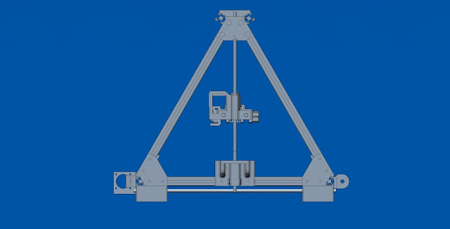

Prism Mendel 1.5
Total re-design of all parts. New X-ends and a new open top.
I'll be putting the files up on my github later this week, I just want to get the first one done to the point that I'm satisfied that the actual machine fits together as well as the virtual one does.

Very nice job Akhlut, I'll probably partially upgrade my machine to your design.
Ah, a quick extruder release X carriage; nice.
And moving the Z threaded rods outside of the frame, good - will need a custom build plate, as a PCB heated bed mk2 will be far too narrow to use all that width then winking smiley
You're going for 2 motors for Z if I get it right ?
Most of my technical comments should be correct, but is THIS one ?
Anyway, as a rule of thumb, always double check what people write.
Re: Introducing the Prism Mendel
August 07, 2012 07:17AM
Yes, two Z motors on the bottom.
And yes, pushing the Z-axis to outside the frame provides a ridiculous amount of room. For example 500mm extrusions provide enough room for 350-375mm in X, 300-320mm in Y and around 250mm in Z (depending on hotend and Y-carriage construction).
August 15, 2012 08:42PM
akhlut
Good job!
How difficult it would be to change X holders to use 8mm rods instead of 10mm?
I do not quite understand why you always put Y rods under the frame. IMHO it does not save the room, it only makes distance between bed and Y rods longer. Am I missing something?

Also I think putting Y motor and bearing outside of frame would not increase work size for Y, only increase size of printer itself.

Don't worry - I have an X-end version for 8mm smooth rods and M8/ACME 1/4" drive nuts. Standard hardware will work with the design.
Placing the rods under the the frame should provide additional Z - about 55mm compared to placing them on top, and about 22mm if they are placed in the center of the extrusion. iven the current configuration, Zmin provides 60mm of clearance between the top of the rod and the tip of the hotend. Less 10mm for the LM10UU's, holders and Dibond drive plate leaves 50mm of space for the leveling screws, build stage and heated bed. That should be plenty of room to accommodate those components. Maybe not enough room.
For a Prism made of 500mm extrusions you have approximately 275mm of Z for build space, and the X and Y axes can fit a 350mm square build plate.
As for the placement of the Y-axis drive-train outside the frame I did this keep the build as simple as possible while maintaining component strength. The component I was worried about was the drive plate. In order to keep as much rigidity as possible I wanted it to be uniform - no cut-outs for the motor or idler. That meant placing the idler and motor outside the frame. This led to the necessity of centering the motor and idler on the vertical face of the extrusion so that the belt would clear it. So the 608ZZ bearing is fine - the diameter is 22mm. And a 36 tooth GT2 pulley has a tooth diameter of 23mm. So now the tolerances for the belting are very tight ~ 1mm to the top and bottom of the extrusion. As a happy accident this means the belts must be parallel for the entire distance of Y to maintain clearance. This is a very good thing as steps/mm will not change over the distance of the Y-Axis due to changes in the angle of approach of the belt to the bed.
As far as size is concerned I think you are right. Modifying the drive plate one could place the motor/idler inside the frame. I wouldn't do it for a dibond bed, but MDF or plywood - why not?
Now that I look at it it may make sense to change the Y-axis rod holders, making them low-profile (not sticking into the frame at all). And I suppose I could alter the Z-motor mounts to provide additional Z.
Thanks rglory! You have helped me to think 'outside the prism'!
August 16, 2012 03:35AM
I understand that. But if you would not let build stage and bed move over the extrusion then maximum work area for Y will be 250mm for 500mm extrusion (btw I missed moment when extrusions became 500mm instead of 400mm) or 200mm for 400mm extrusions maximum. But that in case if build stage exactly the same size as bed, usually it is bigger, that makes work area even smaller.
