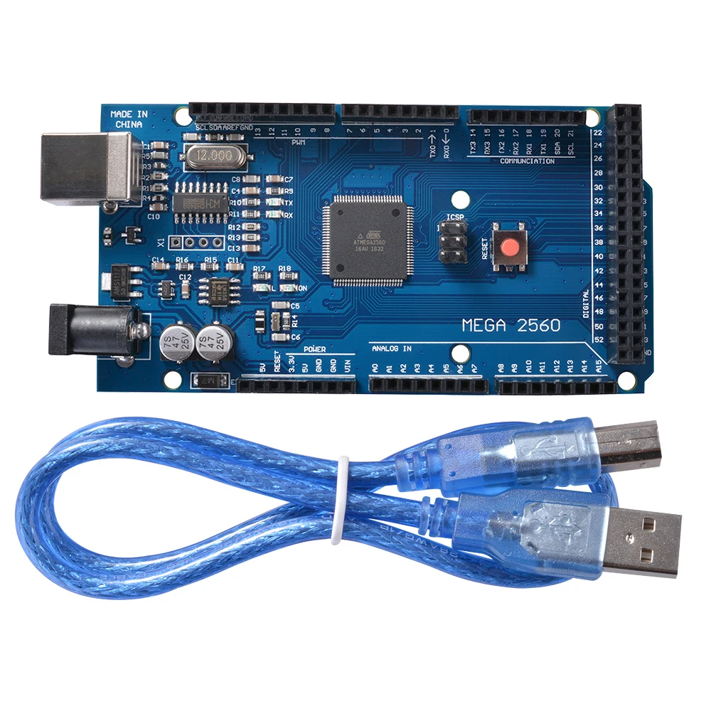

You are using the 12v as the negative terminal and the pwm output as positive terminal. Make sure 0V of each power output is connected, and don't make assumptions by looking at markings and colors. Use a voltmeter to find each psu polarity, then use a continuity or ohm meter to make sure the 0V is connected properly. Also measure the ramps board, make sure which terminal is 0V. Use the schematic to make sure you're connecting to the right terminal.

Please take a look at the schematic of the arduino atmega2560. There's a 5V regulator MC33269ST-5.0T3 or MC33269D-5.0 (I suspect the same regulator but a different package).
If you put 5V on one of the 5V output you put 5V on the output of the regulator. Since the output of any regulator is low impedance, effectively giving it a short circuit. Hopefully the thermal protection kicks in and it still works. You'll need to unsolder the regulator as well but I suggest you use the pwrin (adapter power input) input instead. Just use a buck converter from 24 to 7 to 12V and all should be ok.
Another thing you can try if you're feeling adventurous, you could try replacing the MC33269 regulator to one that can take 24V. That would eliminate the need for a step down converter and simplify the design.
