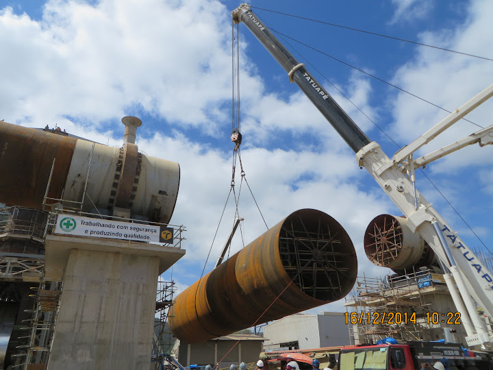

Technologically we (as in mankind - general industry) abandoned this kind of gearing many years ago in favor of gear boxes - And these days we move towards direct drives. Compound systems only remain widely in use on cranes. And on those they are just used because it is inconvenient to handle steel cables with the kind of diameter required otherwise.
Crane doing heavy kiln shell lift
I am not sure how to handle the gearbox backlash, yet I feel fairly confident in saying that more power should be found in either gears or bigger motors, not wrapped belts or lines. Even I am looking towards removing the 2:1 used on my CoreXY's.
