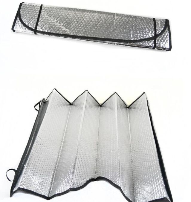

dsol
AND the heat stay !! from 0 (not really, but around 15c) to 80 in no time... to 120 took less then normally do 100c when printing ABS
at 120c cant touch the bed.. too hot ! but can freely touch the insulation bottom (its warm, but not hot)
the bed is off for ~20-30min now and its only got down to ~50 so i think it safe to say the insulation works! not the best, but works...
thanks for the help so far =]
... and your electricity bill will say "Thank you!"
