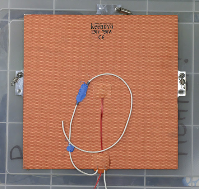

I use the same 750W heater on a 300x300x8mm plate and it gets to 100C for printing ABS in 4.5 minutes.

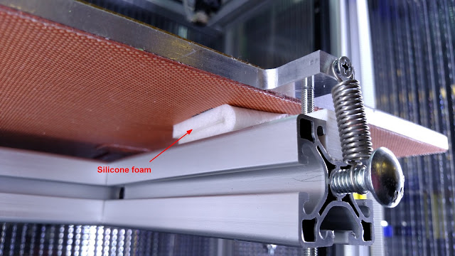

I put my printer's bed design on a blog page including the kinematic mount and info on a thermal cutoff to protect against SSR failure. I mounted the TCO on the bed plate, but it won't do its job if the heater comes off the bed plate, so it is best to put the TCO on the heater itself using high temperature silicone. I have recently found that the adhesive on the heater is starting to let go of the plate in my printer after two years of use. At some point in the near future, I'll peel it completely off the plate and reglue it with high temperature silicone.

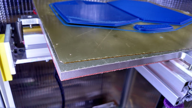

My experience with 2 different printers usiing PEI print surfaces and one with a Keenovo heater is that you've got about 2 years of reliable adhesion with the 200MP adhesive that Keenovo uses and the 468MP adhesive transfer sheets also use, if you're heating to ABS print temperature, and printing a lot (almost daily).
SoM has had the PEI restuck to the plate twice and it is starting to lift at the edges again. The PEI on UMMD (see image below) suddenly let go 2 days ago.
When the adhesive lets go of the PEI, it remains on the aluminum plate, but has lost all stickiness. I didn't check the heater to see where the adhesive is.
