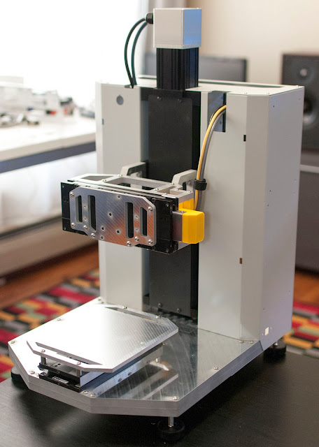

I'll admit its a pretty silly idea. I found the linear stages on ebay and the auction was so cheap I couldn't help myself. After they arrived I had to come up with a project to justify their purchase. Extruder will be an E3D Chimera.
It should actually be a pretty straightforward build since the linear stages are complete and self contained. I pretty much just need to bolt them together at right angles.

I've been making slow progress.
The current problem is that the Aliexpress extruders were producing waves in their output. Probably a bad batch of steppers or bad hobb geometry.
I decided to redesign the whole assembly with E3D titans because they have more resolution and are lighter as well. It will also need very good layer cooling, which is kind of a PITA to route to a Chimera since both blocks are so close together and there are wires everywhere.
Its an annoying task that I've been kicking down the road because it needs a mix of purchased, machined, and printed parts.

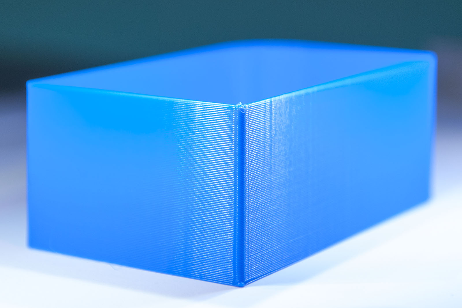

The motion is performing as expected even though the extruder used for this test weighs >1Kg.
I am seeing evidence that the servo gains could use some tuning but there is no point spending a lot of time there until the extruder is finalized. The sample print is PLA at 0.2mm, 60mm/s 10,000mm/s2 with no cooling fan.
I haven't been able to test anything useful because without a layer fan the plastic just flops around if you try to print quickly.

That is beautiful work!
I am working on a similar system:
[sites.google.com]
How did you do your sheet metal?
On cooling, have you looked into the Berd-Air? The guys on the Zesty Nimble group say very good things about it.

Nice project, the Granite Devices drives are a neat touch. I'm using VIX-IH drives, but those things must be twenty years old and there is no way to monitor the position/error of the servos for tuning which will probably be an issue.
I designed the entire printer in solidworks and had local shops do all the fabrication. I've done all my previous personal projects myself, but I wanted to try this instead to see how the quality/cost/convenience compares. Overall it was a very good experience and I learned a lot.
I'll look into using a pump and tubing to bring air, but unfortunately I don't have a good place to mount the pump.

Thank you for the info!
I take some issue with that statement of linear motors not making sense for a 3D printer. With increasing speeds and acceleration the mechanical stiffness of the printer structure matters more and more. This is also true of the stiffness of the drive system (usually belts) and the 'electrical stiffness' of the drive motors (usually steppers). If one takes 1 Kg mass and ac/decelerates at 1G, then F=ma dictates that that results in 10N of force - equivalent to about 1Kg of weight. Hold any printer still (motors powered on), and manually push at the effector with that force, and check with a dial indicator you will see some deflection. That deflection is due to the static stiffness of the printer, and gives the best accuracy you will be able to hold in the ideal case. Dynamic stiffness is an different issue entirely and in reality one will see worse results.
You did exactly the right thing in beefing up the structure the way you did.
All those acceleration and speed settings in the open loop stepper printers have very little meaning, because you never know if you actually reach them and with what accuracy you reach your positioning goals. That does not mean that you can't get pretty prints, but unless you then put them on a coordinate measuring machine you will never know how well they match the model. That does not matter if you print Yoda, but it can matter in some other cases.
The MX80L units we both use are made to be very stiff in all those aspects and servo controlled on top of that for extreme accuracy and repeatability. And even with all that you can see how hard it is to hold the position in the servo loop at high speeds and acceleration. They measure position at the business end with a linear encoder instead of on a motor shaft (or not at all like steppers); and I checked those numbers with a laser interferometer. They do tell accurate positions.
There is a tradeoff between accuracy and speed/acceleration on 3D printers and you can improve on that with increased stiffness. I understand that maybe we are looking at this from different points of view, because I like to build CNC machines and accuracy for me may mean a different thing than it does for others.
