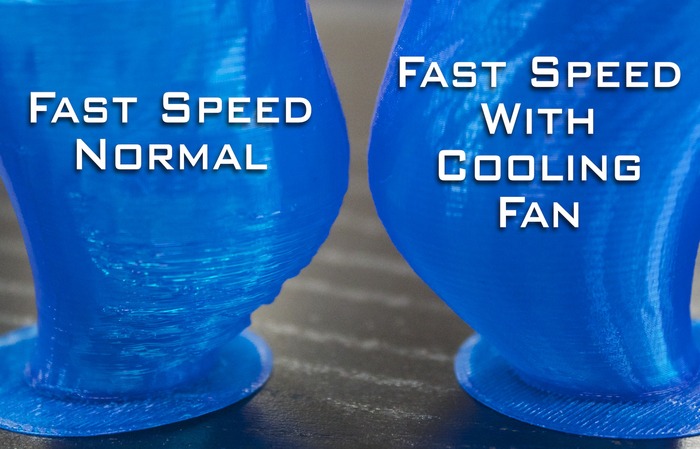

MrDoctorDIV
Fan fan fan. Most common [not sure how you haven't seen that yet, but everybody's experience is different] and simplest and typically the most effective fix. You need a fan blowing under/around the nozzle so that the plastic cools as quickly as possible once it leaves the nozzle.
Just a few examples.
