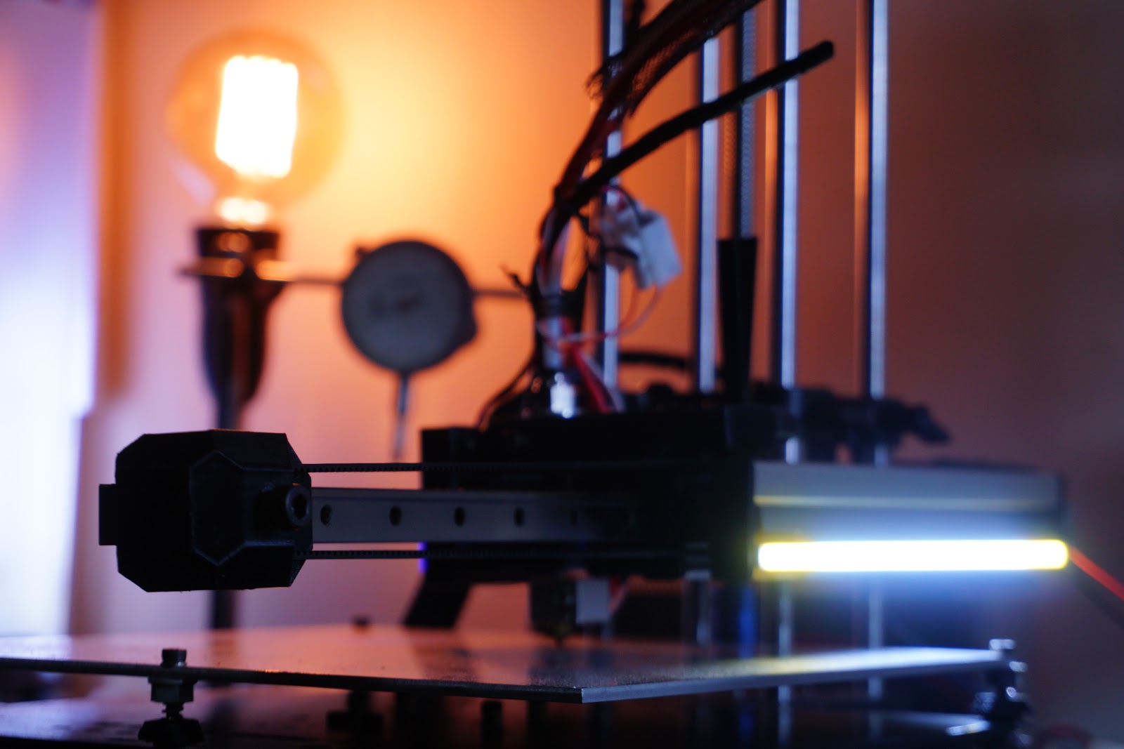

Hi everyone !
I'm currently building a crane style printer (a cetus ripoff to be completly honest)...
I know this is a flawed design (I mean cantilever... come on !) but I really like the compactness and minimalism of the overall machine...
Anyway... I find quite amazing the fact that They are able to run the belt inside the extrusion and yet, connecting it to an MGN12 carriage... I've looked again, and again, and I can't quite find the way they do it... So if you have a drawing, a link to a commercial product that does it... or a picture of your Cetus i would love it !
(I was wondering if they use some kind of crimping connector like these one [openbuildspartstore.com] )

You simply use one large (the drive pulley) and two small pulleys (the far end) at the ends of the extrusion so the belt runs inside the slots.

I'm not sure to uderstand what you are saying, but i think their is a misunderstanding : I mean for me the problem is not the way you keep the belt inside the extrusion, it is how do you connect a belt in such a tiny space (inside the extrusion) to the mgn12 carriage... I cant believe this is achieved with a 3D printed piece...
I've tried many design and the "clamping the belt" part is always the problem, too big for being a 3D printed part inside an extrusion (especially if you use open belt, because you have to overcome the tensioning forces that tends to rip your connector apart !)...
I've spotted this design [www.thingiverse.com] but it does not fit into my aluminium extrusion... And I was wondering how a commercial printer did it !
I don't know if that's more clear...

Just make a sandwich of a printed part which has the same profile of the belt, the belt, and an extension of the linear slide carriage. Use machine screws to hold it all together. The printed part and the belt should fit inside the extrusion.
p.s. What extrusion are you using? Can you provide a 3d model of the extrusion?

Maybe this design of my 'compact carrier' helps understanding? It is designed for 'Bosch slot5' extrusions and works surprisingly well on my Delta. They are made of PETG, which allows me to tighten the belt without breaking the clamping part.
To connect open belt together in a 'twisted' fashion, I simply CA-glued them. That's strong enough, but only works on straights. No bending allowed.

There's plenty of room in the channel for the belt and a locking piece. The channel is 5.1mm wide, so the belt will need to be smaller than that if you want it to ride at the top of channel. You could also mill or file the channel wider to take 6mm belt (Wood routers and tablesaws handle aluminum fine, just noisy and a little more dangerous. Aluminum needs to more securely held than wood). If the belt is at the top of the channel, the locking piece can be 4+mm thick. If the belt will ride entirely in the channel, the locking piece would be 2+mm thick. The locking piece can be as long as the carriage, and that should be enough to secure the ends of an open loop belt. Personally, I'd use a closed loop belt.

There's a twist in the belt so the teeth will interlock at the ends. If you don't mind the twist, just put the teeth together and fit them into a slot to keep them together. I would never trust CA glue to hold a belt.
I used this for the Z axis in UMMD and for the magnet carriage in a sand table:
No twisting needed. When you twist belts you may have problems with them riding on pulley flanges.

Due to the limited space, I would recommend printing the belt profile on the locking piece and use machine screws to hold the sandwich together.

Ok Back on track...3030 has a wider slot than 2020 so a little more space for the belt, and probably better for the cantilever too.
I had the belt running in 3030 in this version, but have since changed the profile for something else.
So now I have to redo hotend part & idler as the clearance has changed.

It's easy enough to design an idler that fits within a 20x20x40(or less if you put your mind to it) envelope(especially with stronger filament) using say 5x5x14mm(flanged but wouldnt matter) bearings x2 = 10mm with a little clearance.(or just one & smaller)
with something 40mm long and gt2 idler pulley with 3mm hole you could use 2 holes on the rail one through the idler & plastic, and another 3mm screw in next rail hole. or with the 5mm example the block could be held with just one screw if it was butted up against the 2020 so it wouldnt rotate plus belt keeping it secure too.
