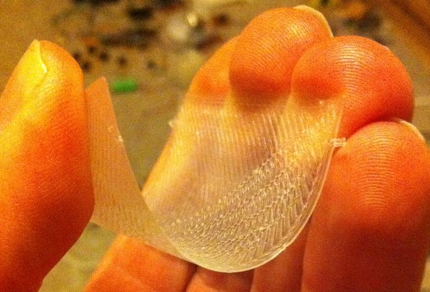

I designed this low vitamin parallel SCARA printer a while back. The current version looks about the same, but it has a printed frame and a bowden extruder. It's not really ready for prime time, the periodic errors in the drive mechanism, with worst case amplitude of almost 1 mm in xy, make it currently a curiosity instead of a general use printer.
The sources for the latest stable version are here.
I'm currently redesigning this, I believe (hope) that I now know what to do differently to make this a working, general use printer.
One thing I was considering was getting rid of the Z rails and screw: making the XY motors static and changing the build platform to move in Z. If it was possible to do the Z movement with printed parts, then this design could achieve a very low vitamin count.
What are the options of implementing the build platform Z movement with printed parts? In this application, it would have to be something that doesn't extend above the platform or below the bottom of the printer. Something that goes from 100 mm to 200 mm would probably be good enough. Sarrus linkages look promising, but they are just for constraining the motion, not producing it.

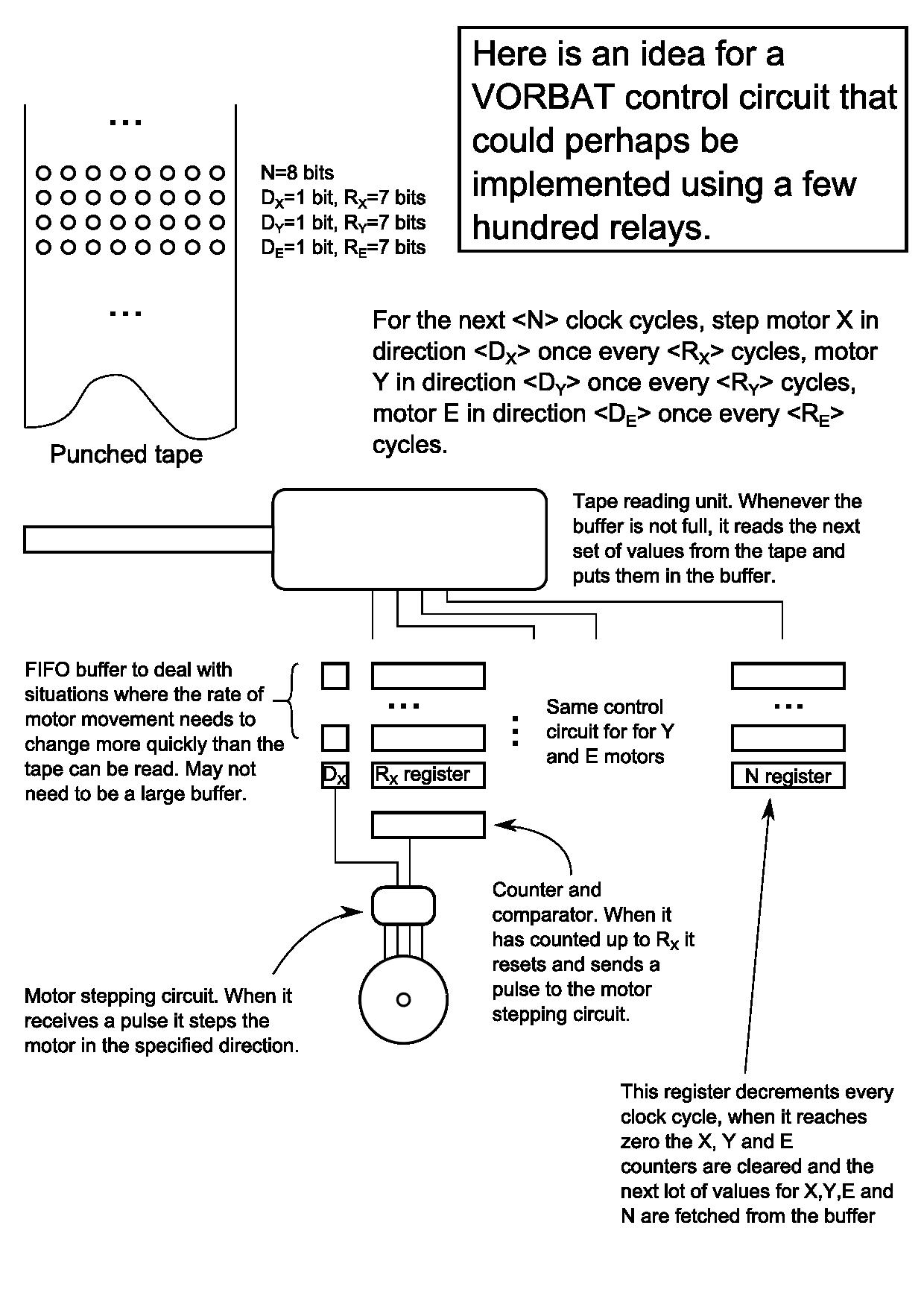

Regarding 3D printers that are as nearly self-replicating as possible, requiring as few vitamin parts as possible, I'm interested in technological bootstrapping going right back to wood, clay, rocks and metal ore.
To begin with I'm trying to work out whether it's practical to make a 3D printer where the only vitamin parts are copper wire, soft-iron rods (e.g. nails), and a pre-built hot end, and the only assembly processes are ones that are reasonable for one human to do in a short time, perhaps with assistance from machines that the 3D printer can make. So winding electromagnets (the 3D printer could print a winding machine to help with that), and assembling the printer are both reasonable for one human, but making a fully functional semiconductor fab completely from scratch is not (not yet at least). Matt described a challenge a lot like this in another topic: VORBAT
The problems include:
    - Making a 3D printable tape reader for reading printed plastic tape - the tape with the encoding on must also be printable.
    - Controlling a stepper motor reasonably quickly using relays.
    - Making adequate stepper motors using only nails and copper wire.
    - Making reliable and fast relays using nails and copper wire. (off-the-shelf relays have an operating time of around 1 millisecond).
    - Working out a suitable electromechanical control circuit for the printer. It must operate quickly, and must operate from an encoding of objects on the tape that is possible for humans to understand and write, and which keeps the tape length short. It need not necessarily be a Turing-complete computer, it could just be a circuit that converts from some compact encoding to a sequence of signals to feed to stepper motors. Here is an outline of an idea about how this could be done (I hope it is intelligible):
    VORBAT controller idea
I think a good starting point is to demonstrate the feasibility of the control circuit by making it with off-the-shelf relays. The electromechanical computing machines that operated from the 1930s to the 1960s had operating speeds of tens of Hertz, though I don't know whether it would be possible to get up to that speed with nail-and-wire relays.

I'd try to stay away from printing the tape, storing a long length of rigid plastic tape is going to be difficult. It might be better just to use paper tape instead.
If you are using relays that operate at ~1 Hz it might make more sense to move to fluidics which can operate at 10s of Hz easily. Fluidics are also a bit easier to print than relays as one doesn't require nails or copper wire. It's also relatively easy to print actuators with fluidics, especially if you can print silicone elastomer. Sensors are easy too, a fluidic tape reader is simply a row of nozzles directed at pipes.
Your VORBAT controller is almost exactly what early CNC machines used. You could probably implement it fluidically, perhaps something like this: [www.google.com]

Thanks for the fluidic actuator patent link. I am interested in the possibility of using fluidic control, and also purely mechanical logic using solid parts.
The reason that I think that relays are more feasible (in the short term) is that there is already a lot of work on making reliable and fast (10s of Hertz) relay circuits, so controlling a reprap using off-the-shelf relays is something that could probably be done right now. As far as I know nobody has built any complex control circuit using fluidics (but please post details if you know otherwise). It will be necessary to work out how to make large, fast, reliable fluidic logic circuits first (something I'm currently investigating Fluidic Logic Circuit), before using them to control a RepRap.
Regarding mechanical logic, I think the most complex non-eletromechanical digital computer to date is Zuse's Z1. According to Zuse it didn't work reliably. A RepRap controller probably wouldn't need to be as complex as the Z1, although it might need to be faster.
Do you have references & circuit diagrams for the early CNC machines you mention? - I'd be really interested in finding out more about those.
The plastic instruction tape would not need to be all one piece. It could fold like in the Jacquard loom ( Jacquard Loom ) and player pianos, or a system of cards could be used, like in punched card computers where a deck cards was used to store a sequence of instructions ( Punched Cards ). Even if it was all one piece, a single layer of printed plastic is flexible enough to be rolled up into a roll with an inner diameter not much larger than a toilet roll inner, see photo showing flexibility of single layer: Flexible single 0.4mm (ish) layer of PLA .

I don't like to pour cold water on what might a fun project with a somewhat steampunk flavor, but I have to say it is unlikely to lead to any practical results. Even a "simple" microcontroller like an AVR probably has in the region of 100,000 transistors.
There is good reason why electromechanics were replaced with electronics, electronics makes things possible that are otherwise effectively impossible. Machines like RepRap are only made possible through the use of very high tech - silicon chips with nanometer scale features made in billion dollar fabs.
If you are talking about only using low tech, then I think you have to keep an eye on the goal, which is to fashion an object out of some material. If you have the tools to build an electromechanical printer, it would be quicker and cheaper to use those tools to build the objects directly.
So that presents a conundrum - to make a home 3d printer it requires technology that cannot be made on a home printer. Removing the high tech part makes the printer not worth the cost of creation.

The only reason for using primitive technology like fluidics or relay computers is because they are easy to replicate. It'd be pretty hard to produce our own microchips without a "billion dollar fab."
Sure a reprap constructed with relays/fluidics may be slow, it may be inefficient, but the point is it will replicate.
One will still need a pretty advanced computer to generate the paper tape, but one needn't use punched tape for data storage and control. One could emulate the tape drive with a computer controlled device. One way you could do this with fluidics would be to make an array of fluidic tone detectors(one for each hole in the tape) that 'listen' to some sort of sound output device and in place of the tape advance mechanism one simply puts a 'whistle'. This way when you put a smart phone with its speaker up against the tone detectors and its microphone to the whistle, it plays several tones together that represent the holes on the tape and whenever the 'whistle' receive a pulse the smartphone microphone detects this and 'advances the tape.'
You could use the whole thing as part of a "RepRap Starter Edition," it may not be the best, fastest, most efficient way of going, but it'll get you going so you can make parts to sell/buy upgrades.
Aside from that, the way reprap's controllers are currently set up, we essentially have a very fancy "tape reading machine" albeit one that uses SD cards in place of paper tape. We aren't even implementing G-code commands for drawing arcs and curves. This NC machine from 1956 probably implements all the G-code commands we really need.
My main impetus for going with fluidics, relays, and other minimalistic control systems is that I'm interested in making a completely self-replicating system. So far, simple self-replicating systems have been made that self-assemble themselves from discrete parts. I think that the next step towards making a self-replicating system is to make a self-replicating system "toy model" capable of manufacturing most of its own parts from preprocessed materials like plastic filament, nails, resin, wire, etc. Making (fast) transistors is simply out of the scope of such a "toy model."

Now on the issue of tape: converting these files for reprap wallace [www.thingiverse.com] to gcode using Slic3r, I get a gcode file that is 315 kb in size. Assuming we can convert file size directly to tape and standard 7 bit tape with a hole spacing of 0.1 inches. We get a tape ((315 kilobytes) / (7 bits)) * 0.1 inches = 0.9363456 kilometers long. Using this online calculator here [www.handymath.com] to figure out roll diameter, and assuming an inner diameter of 1.5"(toilet paper tube), we get a roll diameter of ~ 70 centimeters(~2.25 feet). So I guess this would be reasonable in terms of storage.
This estimate seems high. Correct me if I'm wrong, but the gcode file is probably in plain text format, so each *character* in the gcode takes 8 bits (1 byte) to store. If we use a custom encoding, we don't need that many bits to store a single gcode command.
A quick way to estimate a lower bound on tape size would be to count the number of lines in your gcode file (i.e. the number of commands) and then make a wild guess about how much it takes to store a single command. Will's proposed encoding uses 32 bits (4 bytes) per command (or 24 bits (3 bytes) if only the X and Y axes are commanded).
A typical line of gcode from a slicer (typical according to this page anyway) like this
N7 G1 X2.0 Y2.0 F3000.0*85
takes up 208 bits (26 bytes) in a plain text file (or more if you count end-of-line characters), but using Will's scheme it could be stored in 24 bits (3 bytes). You won't get error correction, and the resolution and maximum travel distance will be limited, but we can live with those limitations.
Another way to save space is by carefully designing the parts so they make heavy use of repeated layers. This was brought up in the VORBAT thread. Many of the Wallace parts, for example, could be made by repeating a few different layer patterns over and over. Then you only need to store one tape per unique layer, and another tape that has the order in which layers should be deposited.
PS - I know we all know the difference between a "bit" and a "byte" but when doing calculations like this it is easy to get the units scrambled up - that's why I was explicit with the "bits (bytes)" notation. smiling smiley

Anyway, I digress! I have been researching relay logic:
- A 4-Bit Counter Using Relays requires 19 relay elements, about 5 per bit.
- a simple 8 bit CPU Relay Computer Two uses 281 relays
- Harry Porter's Relay Computer a larger CPU has over 400 relays, surprisingly uses only 160W.
- switch speed of relay systems is a lot slower than electronics, but may still be quite nippy as shown here [www.youtube.com]
- I have 30 spare relays from work, I might put them to use by building a counter. I found some surplus relays on sale at 40p each, so would cost in the region of £110 to build the 281 relay CPU. I think I would only build that if I can get more relays for ~ 20p each.
