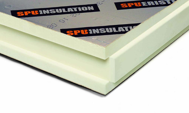

w4rdaddy
I dont know about others but my migbot has pretty robust cables imho for the bed(maybe 2.0m2 or 2.5m2) but it still took ages (+1h) to reach 100c. Solution was to insulate the underside of the heatbed and before printing put something fireproof on the printbed so that the heat wont dissipate. I use a fire blanket folded, and remove it just before printing. Now its about 15-20min to 110-120c for abs.

gatorNic
w4rdaddy
Woah an hour! Mine is not insulated and takes about 10-15mins to reach 105. Although insulation is not a bad idea, it would probably help keep the acrylic from warping on long abs prints.
What did you insulate it with?

gatorNic
w4rdaddy
I just cut a right sized sheet of it and taped it under the bed with kapton tape.
